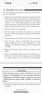

I replace the 68rfe oil filter in the pan and having an issue checking oil level after . What’s is the process for checking level ? Cold should read bottom mark ? Engine on transmission warm 120 degrees should read half way? Hot 170+ should read top mark? Is this correct?
The owners manual does a good job of explaining the process.
60-70°F for cold or 170-180°F for hot.
