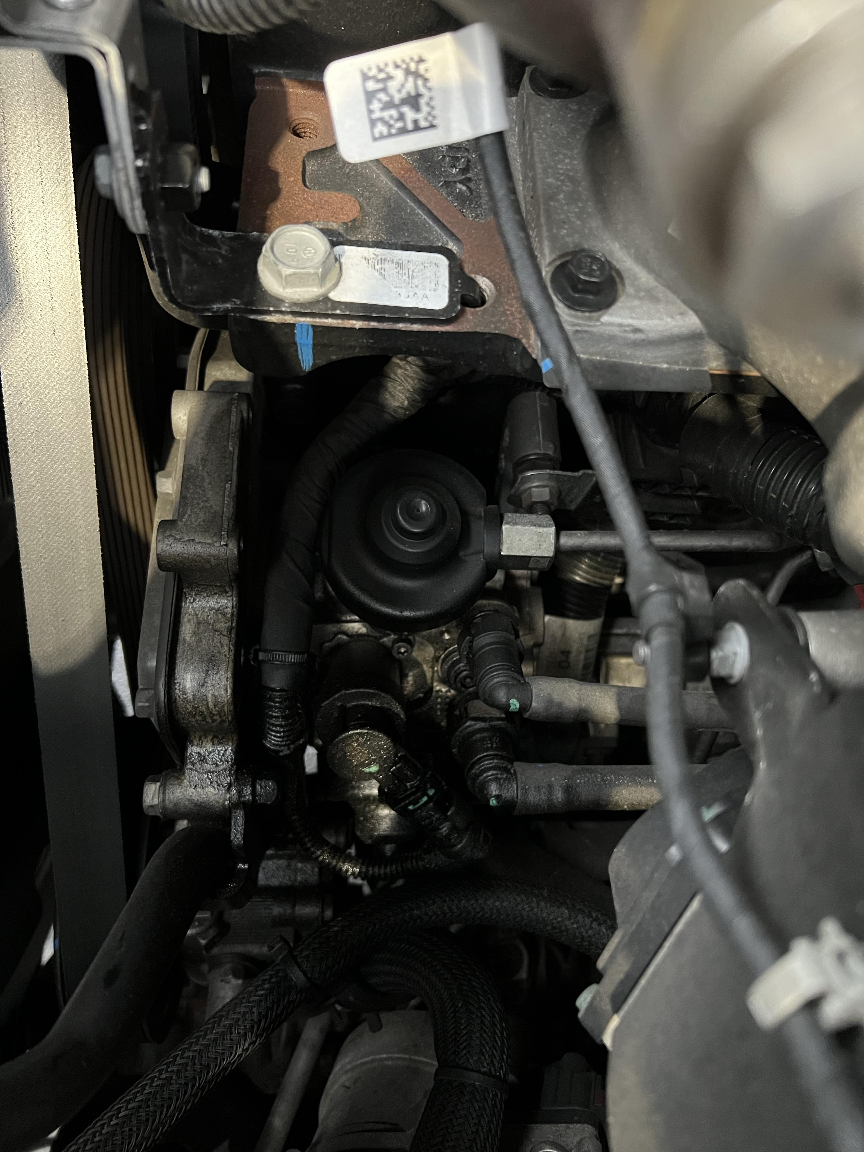

Changing my filters after work this evening and noticed the pump is all wet and appears to be leaking/seeping. Anyone else seen this? 40k on it, no recall parts yet and now this. Should I be worried and park it? I’d rather not deal with a failed pump, I’d be nice to have the recall done before a failure.

Are you sure its fuel leaking? And the CP4 fails internally not externally so id drive it no worries and the dealer can fix you up when you get back
I agree. The CP4 failure issue involves tiny shards of metal spalling off inside the pump and travelling throughout your entire fuel system, has nothing to do with leaks. If I needed to use the truck, I'd drive it. If the leak becomes a drip or a stream, then get it to the dealer.
With the price of fuel I would wire a coffee can under there. Hey that’s probably $5 of diesel sweat right there. :) Seriously though maybe give it a gentle wash down and see if you can determine where it’s coming from. If it’s low pressure location it should be ok for a while.
I have a hotsy at the shop I’ll clean it up tomorrow and watch to see how fast it comes back. Definitely wasn’t like this last filter change.
So far so good today…
Looks like oil blowing back from the timing cover
Spray a little simple green in it and clean it with a small brush and rinse it lightly. Maybe you can pin point the leak.
Oil or diesel smell? Or both?
