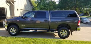

Installed the Mopar mudflaps yesterday. Overall straightforward once I figured out I need to pick up a plastic rivet tool from harbor freight. Had to remove each tire to have enough access to drill the holes for the rivets. Once I got the hang of it it took about 15 mins per tire when taking my time.
Overall happy with the look. Time will tell how much they keep up. Seem like good quality, thick rubber. 19C0FA76-80EB-4C5C-A9EF-D8A3274304C2.jpeg41931EE7-66CE-45A6-AFF9-7D9B24C5016B.jpeg09C0759F-29D2-4B92-8D29-93186EF2419E.jpeg12F90327-D76C-468D-80AD-BE824D7F65AF.jpeg

Thank you for taking the time to post up about the flaps, and add great pictures showing them mounted with coverage.
So, factory flaps, and you needed to drill and add plastic rivets?

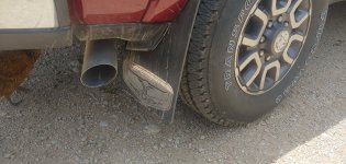

I put on Gatorbacks, essentially same as above. Fit nice, added a hole/boltin the center of the rear flaps with longer bolt to attached to the wheel well molding of the truck for more support. Had to do the same in the front to attach the flap to the lower portion of the plastic molding behind the front wheel. Went to ace and got SS hardware, I installed everything without removing tires. A little overkill but didnt want to them banging around or flopping.
