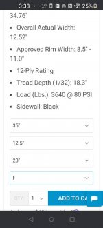

So which is the higher load rating the E or the F and does it affect the ride

Load rating you want to make sure your tires can handle whatever load you’re expecting. Good idea to get tires that have at least the same rating as the factory tires.
