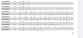

Look at the load index, it will tell you if the tires you want have enough capability. Also, check out a load & inflation table. Some D and E tires are rated the same 3,195 lbs (121 load index IIRC). D or E is a pressure thing, the load index determines the actual weight capacity.
See Sample below
