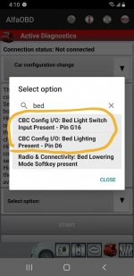

2020 Ram 2500 bed light kit. The settings needed are shown here to enable bed lights for the Mopar Bed Light Kit on 2020 2500.
[mod]
CBC Config I/O: Bed Light Switch Input Preent - Pin G16
CBC Config I/O: Bed Light Switch Input Preent - Pin D6
