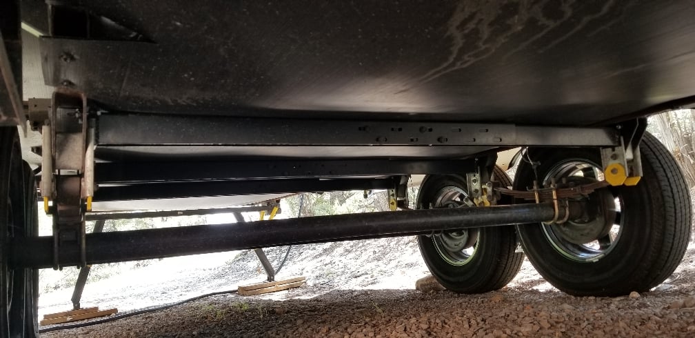

Here's a couple pictures of my lift and cross braces.. so far happy with them and the added bonus of ability to do an alignment on the axles. I have about $500 into everything, 3 morryde x-factor braces and lippert correct track lift kit.
Being my RV is a 2005 I think the “frame warranty” is the least of my concerns. Again, as long as everything is properly tightened it shouldn’t be a problem. Any type of lift can cause failure if you don’t check on things before every trip.
I get why you bought that but man does that look sketchy more so the design but that just adds to my statement about how the trailer industry are hack jobs but if it works for you thats good i dont really pay attention to the trailer warranty's my 97 5th wheel is out of warrenty and my 18 keystone Retreat 40 ft park model does not move lol … there are better ways to do it while blocks are cheaper and also very safe the best way to lift a trailer that the axles are already flipped (or can be used on non flipped axles too) is by making a sub frame that would bolt/weld to the old spring hangars then have its own spring hangars welded to that, you could make em 2”-4”-6” depending what is needed …. I have ran blocks on trailers that we take on hunting roads and trails with out issues but they were old, not the crap that is produced now. Idk how many new trailers i have seen with missed welds or welds beside the joint, porosity welds broken welds its brutal
