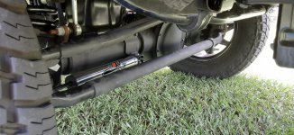

Well myself and a friend installed my Synergy 2.5 Leveling kit, with coil springs, and Fox 2.0 shocks front and rear, plus I added a Carli lower steering stabilizer shock, we didnt get the Carli track bar installed yet due to the torque specs to install on the truck, need a bigger torque wrench.
Pretty straight forward about 2 hours on the front, and about an hour plus on the rear due the upper nut location was a bear, and compressing the Fox shocks onto the axle had to use a pry bar and floor jack.
I will get an alignment this week it pulls just a little to the right, and driver side wheel is out about 3/4 inch from the passenger front tire, track bar will fix that..
I think it looks good, especially since the front bumper adds 280 lbs.
