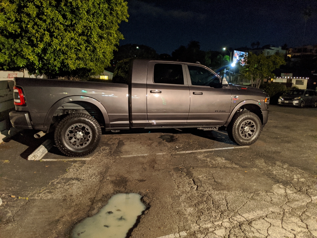

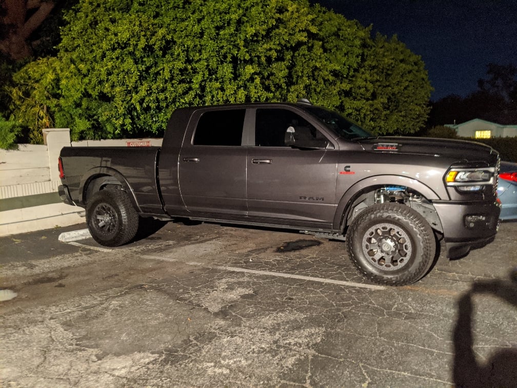

Couple photos from outside the restaurant. The inch matters.

Looks like it's higher in rear. Might of been able to just add the inch to front and establish level looking truck or go with 2" in front. Possibly???? Looks good... More pics with price would be great too thanx..... Looks good.
truck maintains factory stance. 1" higher in the rear. went up 1" with springs in the front and up 1" using a new links to trick the air ride system.

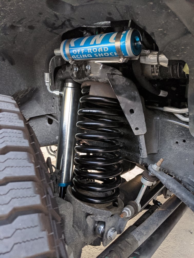

thuren front coils - 350
thuren rear track bar - 380
king 2.5s (tuned to stage2) with external res and stainless steel shafts front/rear - 1125/1115
air ride +1" links - 25
brake line relo bracket - 20
carli front track bar - 435
install - 620
they were ready when i showed up and the truck was done on time as promised. they have the parts in stock. no BS.
i have a feeling i went overboard and spent more on the king 2.5s than i'll ever use off road and that 2.0s wouldve been just fine, but it rides like a new truck. its for sure still not a 1500, but i didn't buy or want a 1500.... i've hit 5 or 6 of the road features around town that were kind of a 'i know this is a 3/4 ton truck, but damn that's harsh.' and they're all considerably less harsh with a more controlled reaction. it just feels 'right.'

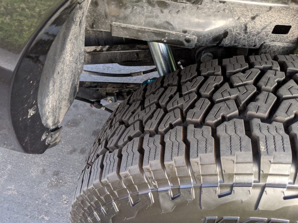

The rear shocks are tough to get a photo of since they go up into a hole to connect at the top. Parking spot precluded the rear underneath shot, but these give you just of it.
