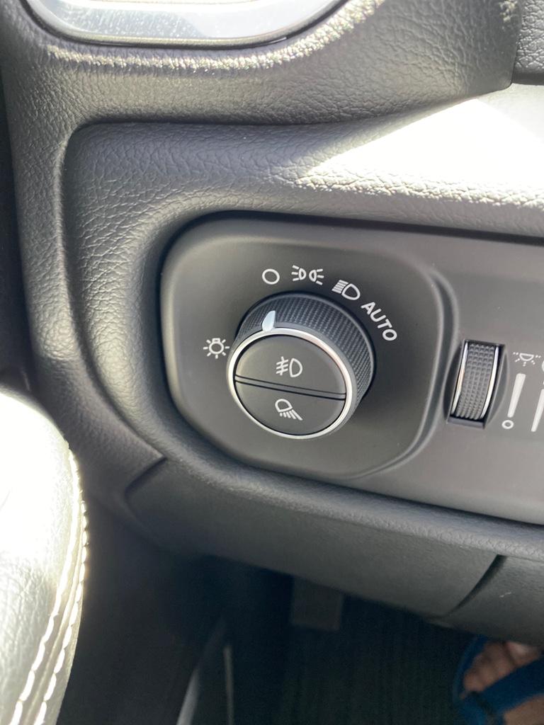

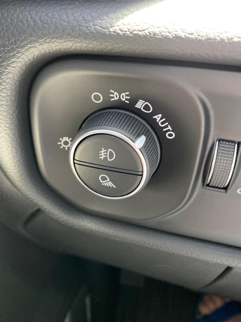

Jimmy i own a Canadian Laramie 3500, with Reflector LED and i want to switch off the DRL's and one i turn the lights nob to off position i want all the lights to turn off, is that posibble ?
in short, no lights on in daytime if chosen Auto
and no lights at all if chosen off
