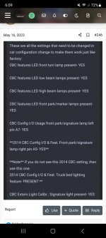

I completed a halogen to led conversion. The lights work fine when the engine is off. But once the engine is started the the low beams flicker then go out. Any idea why? I used alfaobd to change the settings in the attached pic.

My 2014 I had to turn on HID (high-intensity discharge) with led turned on. It took me 3 times for it to take effect.
