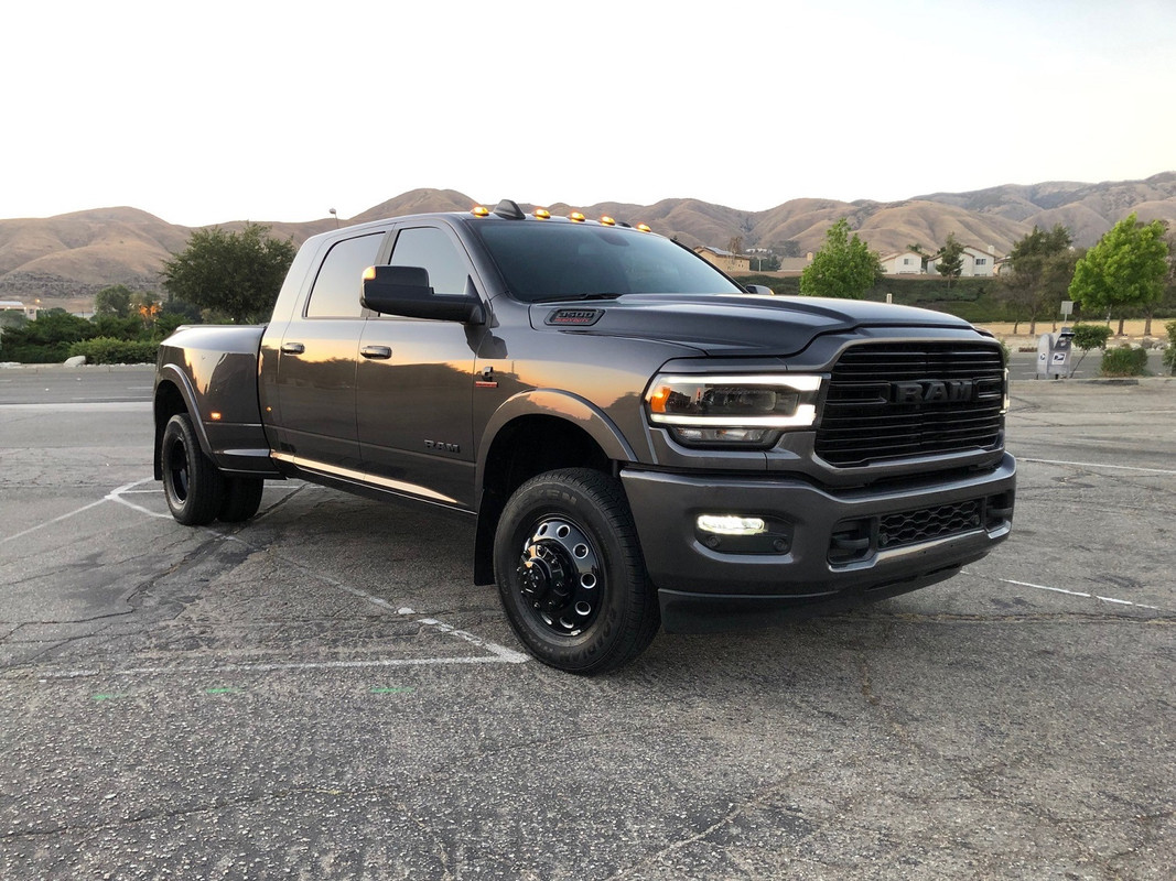

We live in SoCal. Special ordered the truck up in Washington state--flew up on one-way tickets once it delivered to the dealer then drove it 1300 miles home. That entire trip (unloaded obviously) we average 16.1 mpg according to the screen. My hand calc was 15.8 mpg.
We averaged 75 mph so I know that was eating into the mpg some being my RPMs were about 2100rpm most of the trip at 75mph. 3.73s would have kept us closer to 1900rpm at 75 mph and, in my opinion, would have been worth another couple mpg, maybe 1.5 or 2mpg? No way we would have hit 20 mpg with 3.73s, but i bet it would have been closer to 18.
Now... this is NOT a daily driver for me or anyone in my family. We bought this simply to tow our 14k lbs 5th wheel. It does exactly that and it does it EASILY. So easy, its quite shocking actually. I feel like this truck wouldnt even notice another 3k lbs behind it in the case of your 5th wheel at 17k lbs.
Long story short, it does exactly what i want it to, but shes not quite as efficient as i thought she might be. Maybe it'll loosen up some as it breaks in, but for now, we are getting about 15.7-16.2 average on the highway unloaded.
