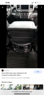

Hello, is it possible to add the USB ports to a jump seat that doesn’t have them? Instead of buying a new one.?
The seat in my truck is the first one. And would like it to look like the 2nd picture. Thanks !
Yes you can add it but you won't have the wiring for the USB or inverter for the AC outlet, you'll have to figure out how to add all of that. It's doable but it's not going to be just a simple console swap
