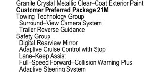

Do you mean the Towing Technology Group B package?
-Center Stop Lamp with Cargo–View Camera -Surround–View Camera System -Trailer Reverse Guidance
Are you looking for the trailer 360° camera kit? If so, you want to find a 68527709AC.
My truck was built with both options, in the mirror and through Uconnent. I purchased it used and didn’t get any of the harness's or cameras.
You didn’t answer which camera setup are you looking for. 360, rear/ backup or both.
Does your truck have the 360° camera?
Or do you have the DRVM and cargo view cameras?
