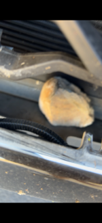

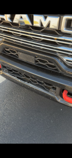

Took a large rock to the front end. No lights or loss of power. Finished the trip towing from salt like to phoenix.
Question is leave it, replace with oem or wait for aftermarket?
Also, any issues with steel bumpers and intercooler flow? Wanting more protection as oem intercooler is $800+.

Plug the inlet and outlet, rig a gauge & air chuck.
Pump it to 10psi and watch for leak down.
