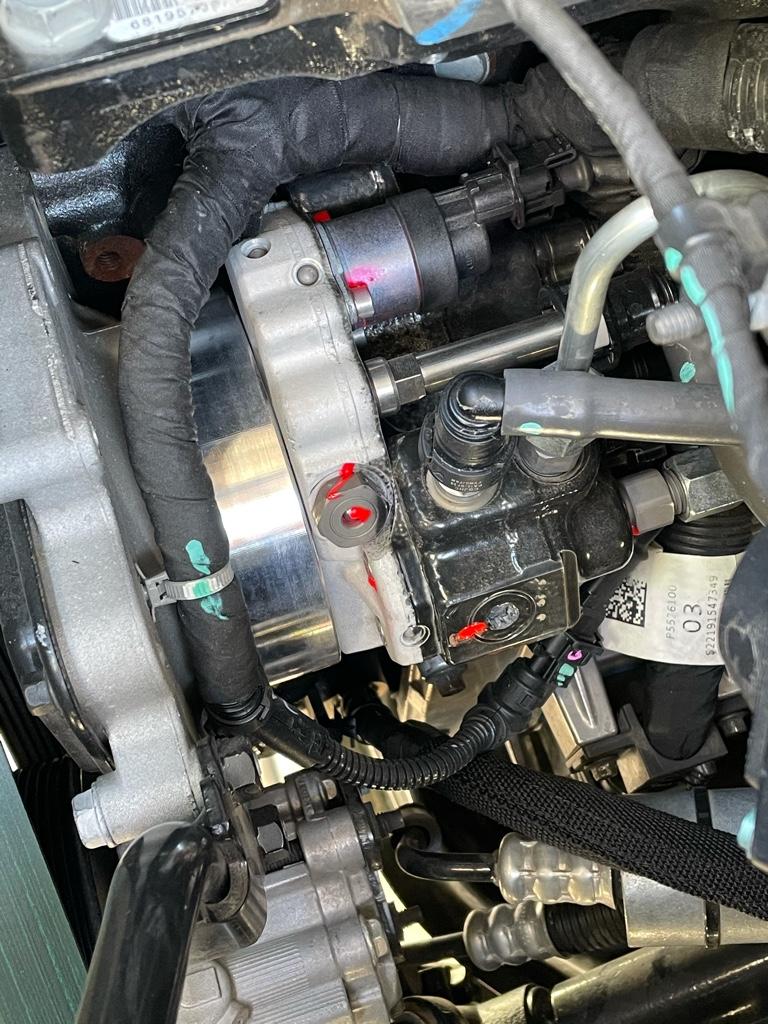

I recently had a local diesel truck shop install an Industrial Injection CP3 conversion on my 2019 Ram 2500 Cummins with stock tuning. This conversion kit is advertised for use with stock tuning so if you have custom tuning then its probably best to go with a different kit.
Initial impressions are very positive. No check engine lights. I haven’t noticed any difference in performance or operation. As a matter of fact, the only way that I can tell the CP3 was installed is by looking under the hood.
The conversion kit cost just shy of $2600 using a promo code and installation was $500. I also had new Mopar fuel filters installed at the same time.
Here’s a pic of the new CP3
