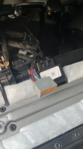

  1. There is a light gray jumper D2621A above the e-brake near the firewall that has BAT+ and IGN in addition to one or more pass through circuits depending on model year.
    • Pass thru circuits are present in the AUX plugs under the hood.
    • BAT+ and IGN dump out to blunt cut wires near/above the spare tire (images down this post)
    • Pass thru circuits are present in the AUX plugs under the hood. MY 21+ have 4 additional circuits terminated on blunt cut wires near the PDC

Context: Hardwiring a Vantrue N4 for constant power with the Vantrue hardwire kit.
Q: If I splice wires 3 & 4 for BAT power on the interior cab on the D2621A connector and wire my dash cam hardware kit in…
Would it be overkill to wire in an inline fuse to “protect” my camera? Or a wise move?
Although i'm sure the line you are tapping into has a fuse, i think it is good practice to have one at or before the device level. I think it is a wise move.
The line you are tapping into has a high amp rating. Your dash cam would specify a much lower rated fuse. If there was a short or defect that would cause a fuse to blow, the line fuse would probably not protect your dash cam as by the time it blows your dash cam would be ruined, whereas a lower rated fuse would blow much faster/earlier thereby protecting the dash cam. Make sense?
Absolutely! Crystal!
Cam hardwire kit is designed to tap direct to the fuse box, existing fuse port with an additional jumper fuse. 20amp. So going to splice BAT off of D2621A.
Red wire in image came with kit. (Not using)
Bought in-line fuse, black on right which will be used to splice in RW 3&4 wire on D2621A.
Added a female bullet terminal to the cam side, and the hardwire kit has a male ending. No soldering.
If I don’t blow myself up, will post pics
