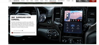

This photo shows the option on the 2022 1500, hoping it's just a software issue
Can’t go by the photos. It’s not a software issue. The 1500 central vision processing module (the module that handles all of the cameras) doesn’t even have a cargo camera input on it physically.
