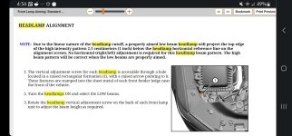

Trying to lower the high beams as they are shining totally above the low beams. Example lights on a wall about 20ft away. Low beams about 4 ft high. Turn on the high beams and they are above the top of the low beams and much brighter. Lux meter about doubles. Driving at night the high beams do a really good job of lighting up the top of the trees along the road :). I don't see any adjustment spots on the housing. Is this something that is done through programming?

Ok, found the answer. The Limited headlamps are AFLS (Adaptive Front Lighting System.)units which are controlled by the BCM and a couple of other computer modules. The adjustment is done using a DTC terminal. No manual adjustment.
Mine were really high likely due to the BCM being replaced about 15 months ago and I don't do a lot of night driving.
There is manual adjusting available, via a screw just like every other headlight. It adjusts the angle of both the low and high beam together. There is no way to adjust the beams separately as they are, as stated above, the same beam.
The adaptive part of the lighting is only side to side swiveling. The lights do not move up and down.
