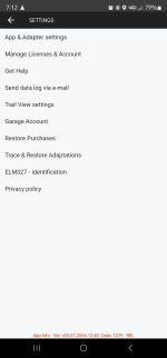

I'm going to be making some changes with Jscan to my pickup but before I start I'd like to have a file made of the current settings. This would be a backup so if I screw something up I can always reload all the original settings. Does anyone know how to do this? Thank you
Connect to your truck then tap the gear icon on the top right, from that menu go to "Trace & Restore Adaptations"
From there you can make a backup file
