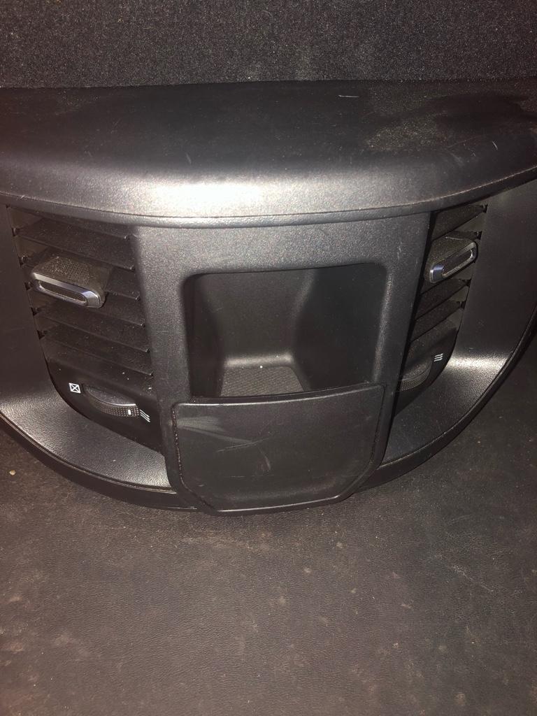

I want to install a 12v outlet on the end cap of jump seat for backseat. How do I get the end cap off? I want to mount it between the two vents, but can’t figure out how to remove it.
2edit usb.jpgThis piece has a screw behind it roughly where the X is. The piece itself pulls off with some effort. Then the whole thing including the vents pull off straight back horizontal toward the rear seat. I just pulled mine but didn't know about the screw. It attaches with 5 push in clips. 2 on each side and one centered in the top where its flat. The first pic shows the clip almost inserted. The other is what the clips look like. They are tight. I gooned it when I missed the screw. Disclaimer- I swapped to rear usb and had replacements, I wasn't worried about saving the originals.IMG_20210625_170730899.jpgIMG_20210625_170722527.jpg
