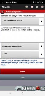

Most will just disable the panic feature via AlfaOBD programming-
LIN & Misc: Panic Enabled- NO
Jimmy07, it gave me this error when trying to disable. Have you seen this before?
