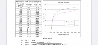

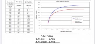

Did some further research and found 2 additional options:
1) oem 220amp alternator, p/n 56029644AB, costs about $500 for a new unit, $400 or less for a reman unit. Looks to offer decent performance improvement over the 180amp and shouldn’t cause any issues since it’s an oem component. They said for pretty much the same price the 320Amp PB one is pretty tempting
2) mechman 370amp alternator. $700.
worth noting. I seems the OEM 220A Alternator and these aftermarket ones are “hairpin” style vs conventional “S-wound”, which makes them more efficient and able to produce more amps at lower RPM. The OEM 180 Amp appears to be conventional S-wound.
