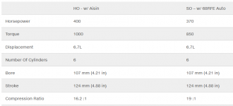

...different compression ratios (many assuming pistons).
Has to be pistons - bore/stroke is the same for both engines but HO compression ration is substantially less than on the SO. HO gets extra grunt via the turbo. From the link provided by @thestuarts:

As I already stated, pistons and injectors are what everyone is saying.
There is no significant difference between the 2019-2020 SO and HO engines.
Your reading too much into a couple marketing videos inaccurate assumptions.
Go look here: https://www.cummins.com/engines/cummins-67l-turbo-diesel-2019
ETA: CP4 repair kit has a single part number so that rules out injector differences. Tuning and more boost and as said, pistons.
SO compression = 19:1
HO compression = 16.2:1
