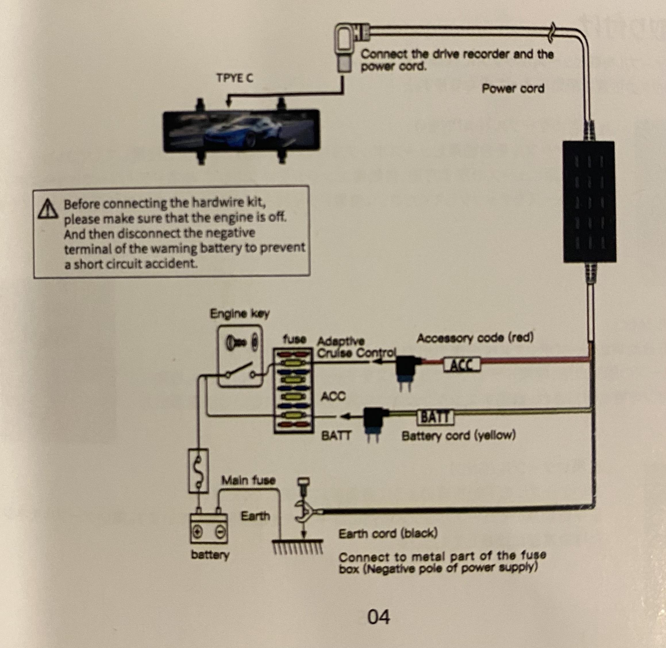

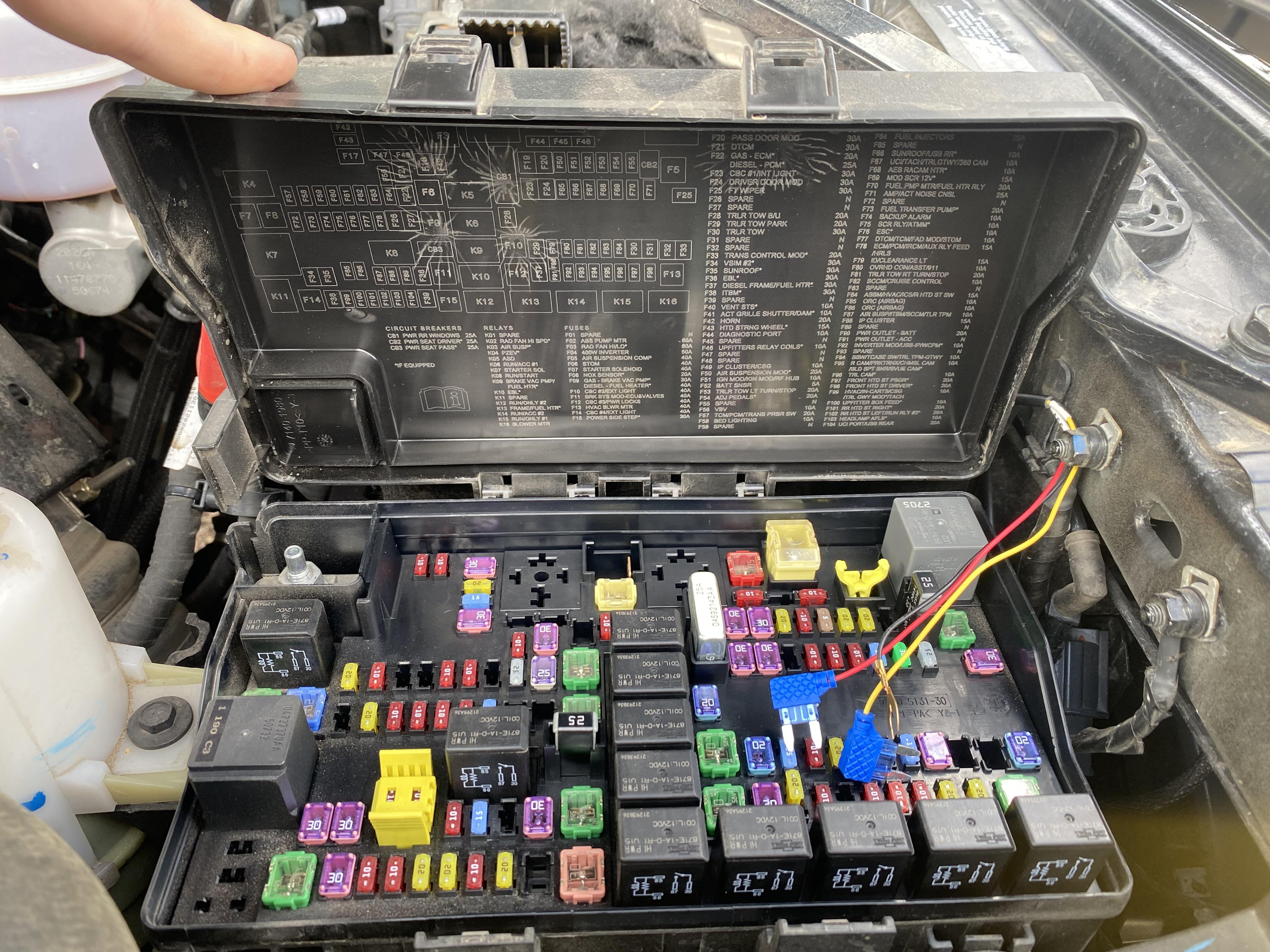

I’ve got all my stuff hung cables routed, but I’m stuck with where to go from here. Obviously the “fuse”-style end won’t fit, so those will need to be changed out. I’ll have to figure out what size fuse to come off; one is constant 12v, the other has to be tied into an ignition source.
