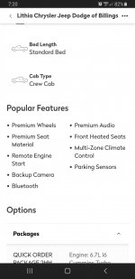

Side question.... Does anyone know the part number for the hard switches for ventilated seats? My dealer is being difficult since I added cooled seats (when they were adamant that they wouldnt work) They are telling me I have to buy the whole center stack. I find that hard to believe that is my only option...
