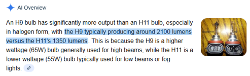

Oh look, AI search. So nominally you can expect 55% more low beam output and 35% more high beam. Except the bubs I've suggested are best of the best and your current bulbs are probably factory "long life" units, so it's save to anticipate more than that.
