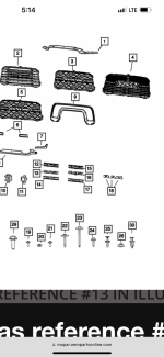

Looking to swap my tradesmen grill for a Laramie grill. Will the emblem back plate for the tradesmen be interchangeable with the Laramie grill? If not, will I need 15,16 & 17 below? It has the front facing camera, which I do not have so I guess I will have to plug that as well.

The backing plate that you are referring to on a Tradesman grill is molded with the rest of the grill and not a separate piece like the higher trim grilles have. The part # for the backing plate without the camera provision is 68459112AA.

Thank you, picking it up about a mile down the road at the local dealer soon.
