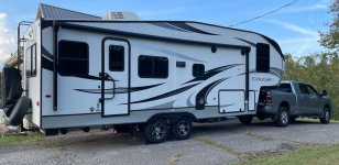

This picture was taken with the B&W Companion hitch and the short bed (On level ground).
I think the adjustment on the hitch was toward the rear and gave me 4” min clearance from the window.
This was on my old 2015 2500.
I changed to the goose box later but don’t have pictures handy of the clearance, but was less than the picture shown.
Now I have a long bed 3500, big difference in ride comfort.

Yes, I've got the short bed. I have the Gen-Y offset ball which I have used and I've also got the B&W ball that is not offset that I have also used. I have to admit that I am more comfortable with the offset even though my brain says it isn't necessary.
My Cougar has a curved nose cap which provides essentially the same clearance throughout the arc of a turn as when the camper is centered.
When making turns and especially when backing, one really shouldn't make 90° turns. As much as it is hyped up as an important thing to be able to do, it is extremely hard on the suspension of your camper. People have broken axle hangers that way.
In reality I can't recall a time when I turned more than 45° from the camper.
A plus to using the offset ball is that when backing up to the camper with the tailgate down it gives me a little more clearance between the tailgate and the front storage locker. This can be important when hooking up on a campsite that is off camber or has poorly placed trees.
