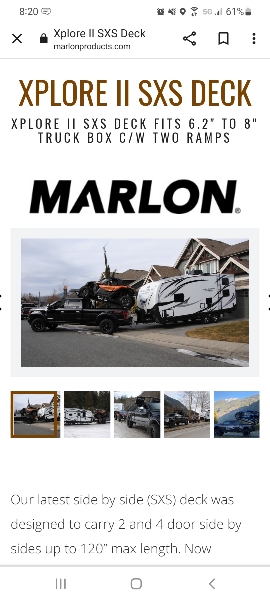

I have a 2020 2500 6.4L with 6'4" bed. I pull 32 foot travel trailer and would like to get a golf cart. Does anyone have any pictures of this and/or suggestions.

There are UTV racks made for this purpose. Just google it, many available.

You gotta get a deck...
