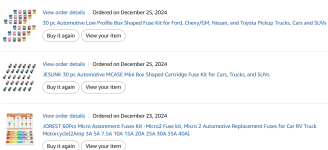

Amazon fuse packs for the assortment of fuses FCA decided to use (three types), or you can buy a small assortment from Genos...plus the other types of fuses for your camper.
