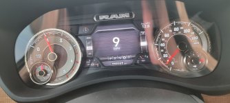

Gear indication next to the right of the odometer
rudyyoko
67
59
When I it the plus or minus on the gear selector, I get the display which shows the gear I am in and the gear that I have set for a max. In my 2019 ram i could set that up to display all the time. My 2022 ram laramie CTS 4x4 crewcab, I cant find a place where I can set this up, any ideas?
On my 19 diesel that feature wasn't available right from the factory floor, it has to be enabled either at the dealer or with alfaobd.
The dealer can enable that to display all the time?
More info please. I would like my dealer to do that for me if its possible.
Thanks!
Thanks!
Several tried and were unable to get the dealer to enable it. It's not a sales code that can alter and they don't have AlfoaOBD to do DIY tweaks.
Sorry for the wrong info, looks like it’s just alfaobd then!
There's also a specific common DIY codes and links sticky here.
