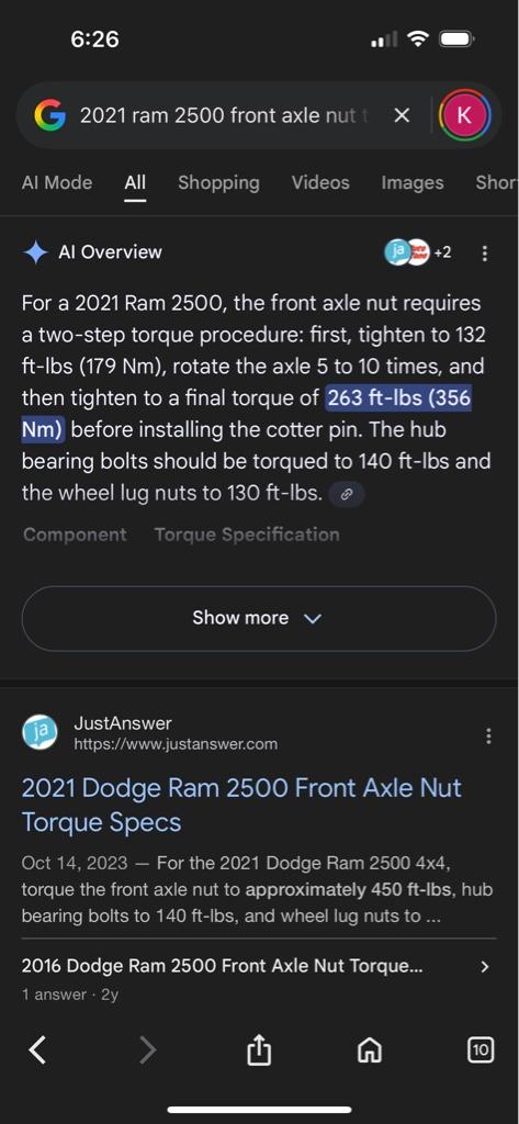

Some shops use an impact wrench to tighten the axle nut. I believe this can potentially cause the bearing to wear prematurely.
From our AI buddy(taken for what you paid for it!). I’m not sure of the socket size but I remember the spec being over my Snap On wrench’s limit.
