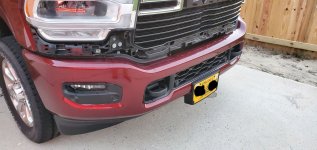

I was actually able to remove the trim under the grill and those two beside it. Removing those two side trim definitely the hardest in this task. I feel like I had a heart attack for each side when I pull them out. 20201007_162649.jpg
Going to finish pulling out the grill later on.

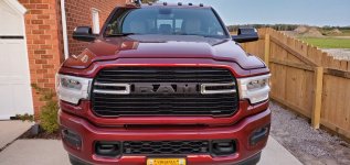

I like the flat black better. I do wish the side trim would come in darker black instead of blueish.
Those are definitely meant to be painted. They will fade in the sun unpainted as they are ABS plastic. I have a set to put on my truck when it gets delivered. Haven't decided if I want to paint them satin black to match the "RAM" or gloss black to match the grill.
Aww man, do I really have to pull the grill out again....
I did the same thing and ended up having a shop paint them gloss black to match the rest of the grille.
That looks great! I do like the idea of those trim pieces matching the rest of the glossy grill fins. But for now I think I am going to try satin black for both R A M and trim pieces and get a feel of it first.
