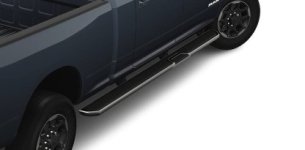

I believe I do. I'll have to get that for you. Oddly enough, the steps I originally received were too long for my truck. They actually were touching the wheels. I'm not sure if they were for the Mega cab or for the LB. It appeared that the mounting points lined up, just the rear portion was longer than what is required for the CC. Either way, I'll get that part number and you can check with your local parts department to see if they fit your truck.
Part # 68361680AA, RGT Step. I didn't write down the left. I'd venture to say it's 68361681AA. I called and the parts dept. at the time and they found the corresponding part # for the left side.. It appears there are 3 size of these steps. Cab, Length, Wheel to Wheel for CC and a longer versions that seems to fit both Mega Cab and LB. Double check though.
Wheel to Wheel LB
Wheel to Wheel MC
It appears in the photo generator on the Ram site, the LB WTW steps are just short of the fender arch. Where as the MC reaches all the way.
Appreciate all the info thank you very much! Should be exactly what I need to go forward with this.
Great. You're welcome. Hope it works out for ya. Just be sure to get the correct hardware. I was given bad info originally and had to order two different sets before I figured out the correct set. What I posted above will work. Make sure they're flange bolts.
