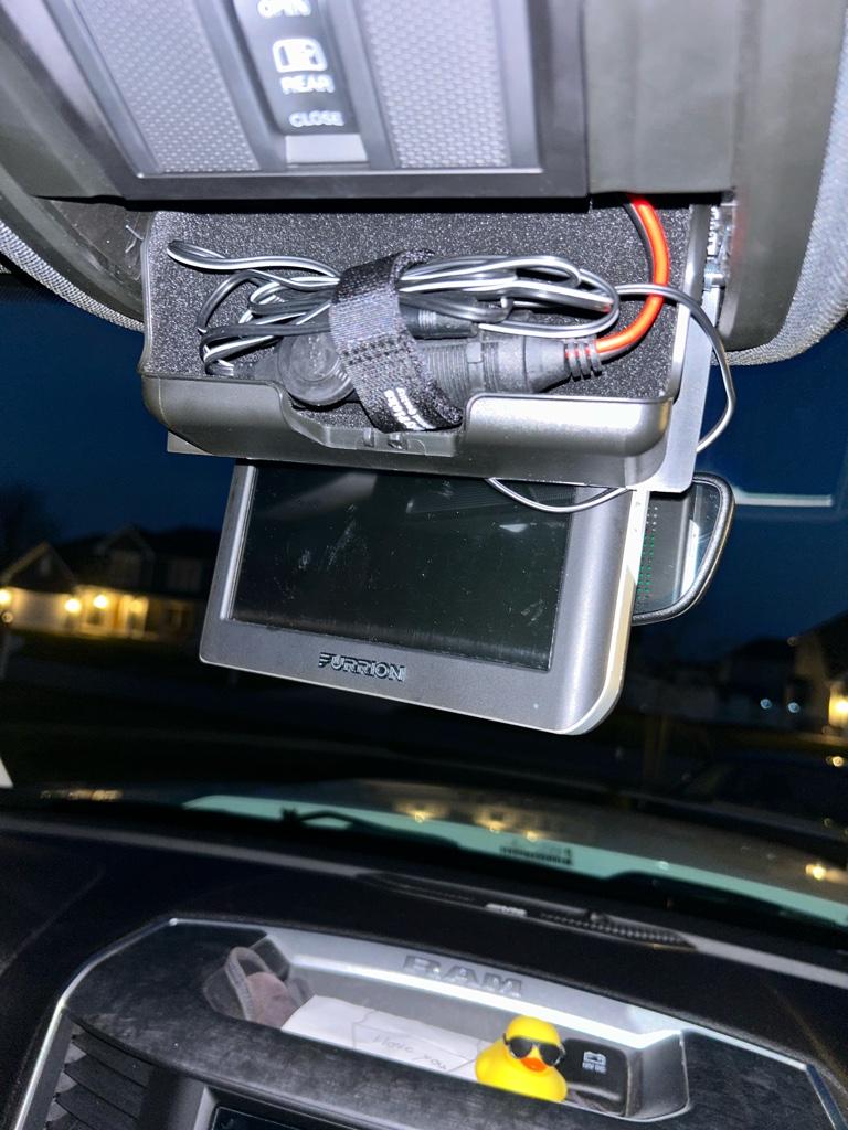

After spending weeks trying to find a solution that didn't impede more of the drivers view I found one that felt very natural while driving and thought I'd share the parts needed incase anyone could use it.
For background I have a 22 Ram 3500 Mega Cab Dually. In the center of the windshield I already have a VIOFO A229 and the digital mirror surround is already pretty large. I also have a Garmin 895 RV GPS underneath that suction mounted. I'll be moving that to a bulletpoint mount to drop it down and out towards the main screen for more visibility. What I didn't want was the GPS screen and the trailer camera screen in the center.
What I found was having the monitor to the left of the steering wheel was helpful as I am already glancing that way to use my mirror. After much trial and error with various ram mounts I've got it so it does not impede the steering wheel, has sufficient gap behind to allow the ac/heat vent to flow, and does not hit the window. Pictures attached.

Handlebar Clamp: You can remove the lower 10mm bolt on the A pillar grab bar of the truck and replace it with this. I had to use a new bolt that was longer along with a thick plastic washer (about 1/4"-1/2") to push the ball out further from the A-Pillar. I had a bolt and washer laying around that fit so I'm not sure of the thread size but this is easy to figure out by just taking the 10mm bolt that you removed to the hardware store. The plastic cover on the grab bar can be removed from behind by using a small pry tool if you don't want it hanging off.
Double Ball: The 1" double ball (#3 above) will not fit in to the Furrion monitor. It is almost impossible to find a 22.4mm double ball that fits the Furrion Vision S monitor. You can find ones that have a suction cup etc but not one that has a 1" ball on the other end. There is a 1" to 22mm ball available on ebay that says it is for the Furrion Vision S but when I ordered it it would not hold the monitor. It pops in to the socket but is slightly to small so the monitor droops down.
I used course sandpaper and a dremel (a bench grinder would also work) to sand one ball down to 22.4mm. I did this very slowly, going round the ball once or twice with the dremel and then test fitting it so I didn't grind it down to far. It takes some patience to get it just right. You can use the mounts that come with the furrion to compare the ball side to side with the one you are sanding down to get a rough idea of when you are getting close.
Set up worked well going across the NC/TN mountains which has some rough areas with plenty of bounce.
