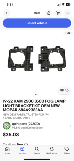

I have the following saved in my notes…don’t remember who I stole it from on here though.
The bracket for the round lights is p/n 68449343AA, the bezels for round lights WITH parking sensors I found is 68449343AA​

You need the bezels and the mounting brackets, as stated above.
I have my Baja designs sae fog lights wired to be on with the parking lights and have no regrets there. They come on with auto headlights.
I bought the bezels cheap online. Also pictured is the mounting bracket but it has the Baja designs bracket attached to it in this pic. Neither came with hardware but I found some easily

Does the Baja kit come with that plastic mount as well? Guess I didn't realize there was adittional parts outside of the bezel and light

you probably need that part. I did. [edit: your kit may come with these, see reply below] There was nothing behind the factory blank bezel to mount the lights to.
It’s possible the kits are more complete now. When I did this it was 2020 and the models were newish
My Baja kit was complete. All brackets, bezels and wiring were in it
