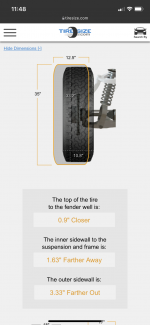

Each 25mm of offset is about 1 inch so if you’re going from 57mm or 50mm of stock offset to -6mm then that’s about 2.25-2.5inches that the wheels will be sticking out from their current position. You also have the 8.5 wide wheels so subtract a few mm off the above calculation.
Personally, I’m doing 18x9 0 offset on a 35x12.50. There should be minor trimming, if any on my setup. I’d imagine it would be minor trimming for your setup as well. You can check Custom Offsets site to see if anyone has a similar setup and see if they did trimming.
It really comes down to what tires as not many 35x12.5s measure 35” so figuring out the tire and getting actual numbers from the manufactures site will play a big role in rubbing but with the offset you most likely will have to trim the pinch weld
Not knowing what your factory setup is i just used the oem 18” size if you have the 20s it will be close to the same dimensioning ….
