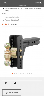

there is no reason to over pay for a hitch they are all engineered with a weight rating for a reason no need to buy the most expensive ones that does not mean its safer buy a quality steel adjustable like this curt i use and never look back

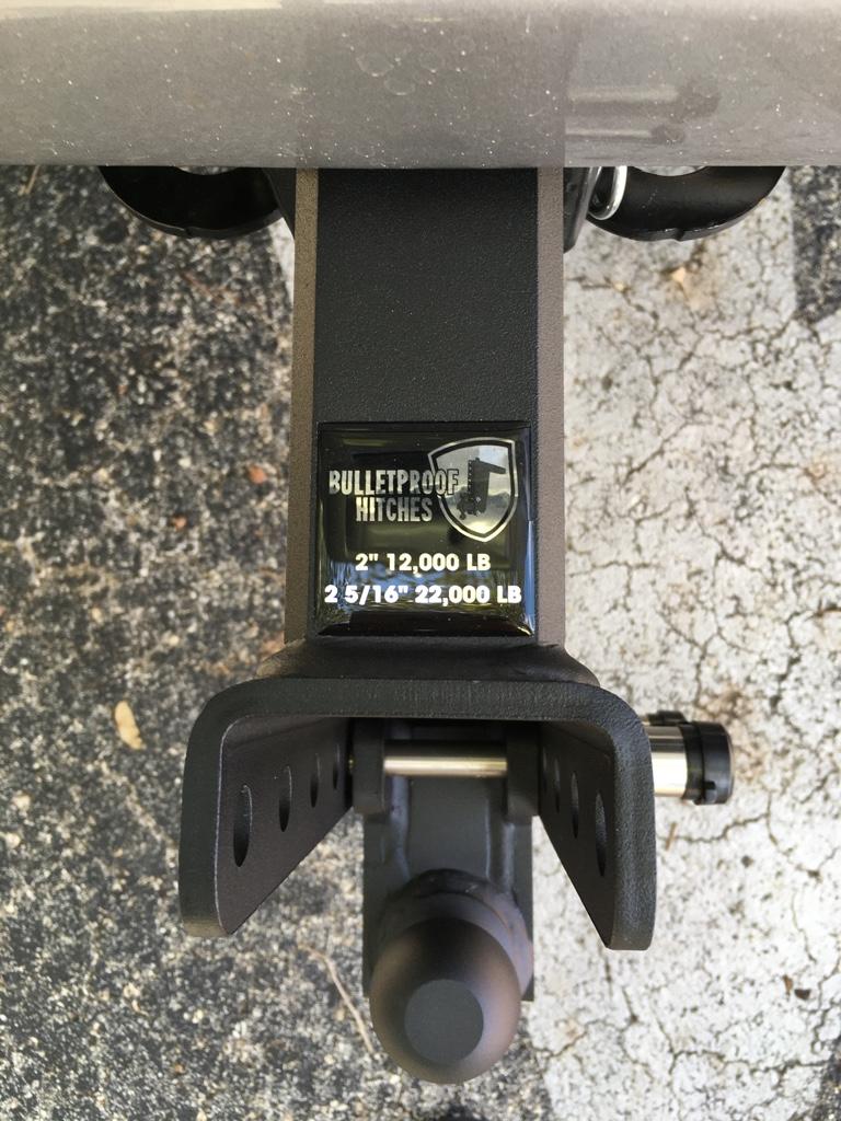

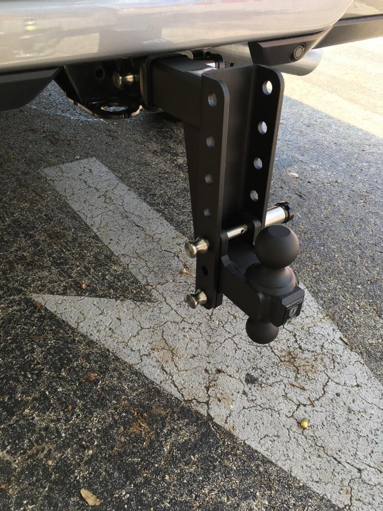

I drop pull enclosed trailers daily that range from 8k-10k. Pull vehicle is a 2500 mega cab 6.7L 4x4 ORP. I use the Bulletproof all over Tampa area with zero sway at 75mph on I75. Very stable and no slop in the hitch at all. Their hitches have a lot of options, including sway control. Not discounting WD, as it has it’s advantages, but not necessary for my application.
