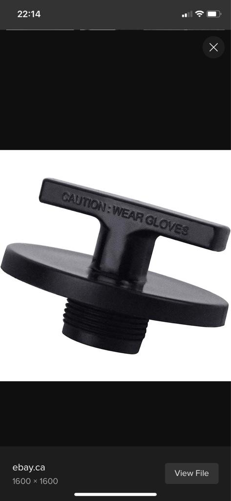

Ok I work for FCA or Stellantis or whatever were called at the moment, they did some things right and some wrong. The drain plug with the 3/8ths square hole is nice. I did replace with a valve but that was a good idea. The oil filter though, I am going in tomorrow and find the genius who decided where to put that and have a chat with him. I know it might be cummins but I would think they talked to each other and thought that getting it through the wheel on the right side was a great idea? Very stupid if you ask me and just my opinion. I have the cap because I read up on it before doing it, and that is the dumbest spot to put that I have ever seen. I just traded a F350 with 180 thousand and did a lot of oil changes, the filter is nice and easy to get at. Ram could have done a much better job with this. Ok I am done ranting, thank you for reading.

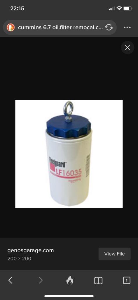

Geno’s Garage , who specializes in Cummins parts and tools has a solution to correct this issue. It works great as well. !!

I use a tool like the one pictured above from Geno's, no mess at all.

I also don't really have amy problem with the cummins oil change, provided you have the filter tool. Once you drop the filter it rests nicely on something, put the filter cap tool on and boom done. Clean cap tool well and use it to insert new filter filled with clean oil.

Dont even need the cap i just grab it blocking the hole with my hand when i pull it out of the fender
