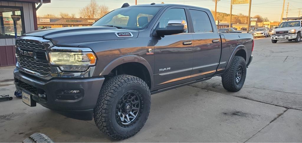

2020 2500 leveled with 37’s. Worth the wait for sure!

What did you have to cut for them to fit? I have 35’s and they rub a smidge with 2.5 front 1 rear level?

Took off the little square plastic end cap on the back of the front fender, then trimmed about 4” of plastic and a small sliver of the metal pinch weld. After trimming the plastic we also pinned it back towards the body to move it away from the tire just a little. Turned out to be way less than I thought!
