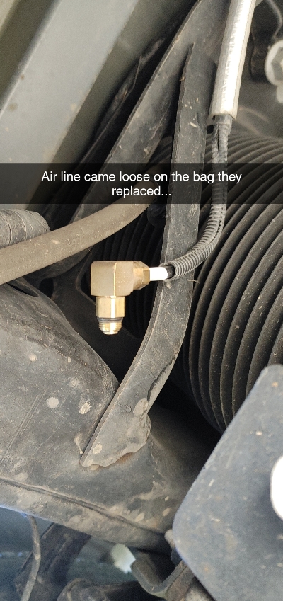

Back in August, I had the driver side airbag burst pulling out of my driveway after hooking up to my travel trailer. It was fixed by the dealer under warranty. Fast forward to december, driving down the interstate completely unloaded and the same bag blew out again.. So I checked it out and saw that the air line had come undone from the bag...dealer cant check it out for another week, so im thinking ill hook the air line back up and see what happens when I start the compressor.

Update* I plugged the fitting back in to the top of the air bag but it never really felt like it got tight. I fired the truck up and the compressor kicked on and inflated the suspention like normal. Well, at first it was lop sided until I moved the truck from its parking spot then it leveled out better.. Seems like its not a sealed system but I cant say for sure.. Still taking it in monday to get checked out.

Did they have to vacuum the system out? Then add the nitrogen back to the system? My 22 ram 3500 with air assist. Had the line blow away from the push in fitting on the drivers side air bag. Pushed it back into the fitting. But not sure its in there good enough.
I have delt with these push in airlines for years in Semi trucks. Always feel them snap when its in the fitting. But now mine is back to working. Will get it into the dealer and see what they say. Hauled our 2016 Eagle Cap Truck camper back home 650 miles. Went to move it in the shop and a giant gush of air came out.
