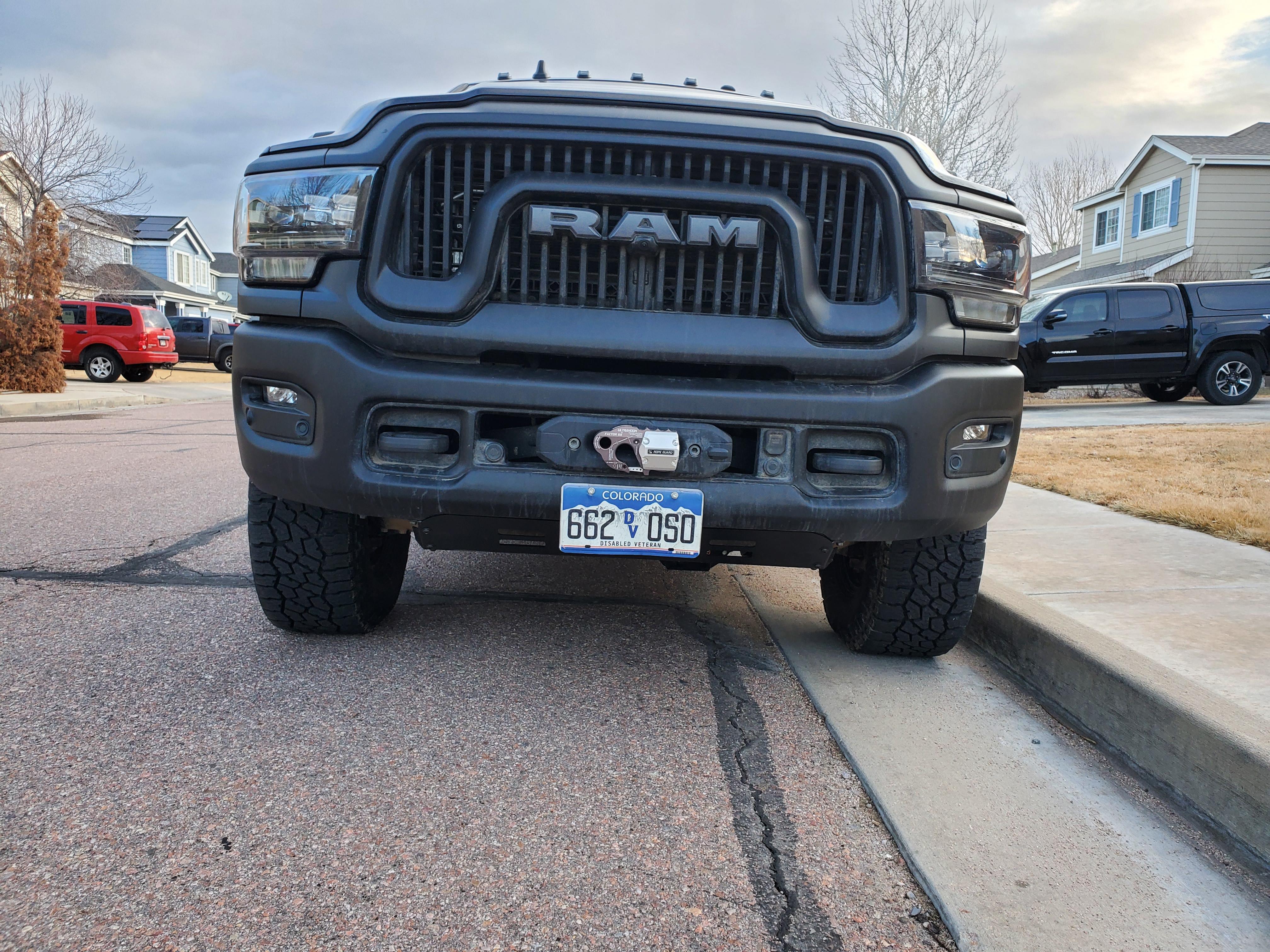

We’re these both the standard versions or the XXL versions? Looking at the stock winch lead the loop just appears bigger than what would fit in the attachment slots of the standard size units? No modifications needed to the winch line ends?
Nope, no mods. Just remove the pin and slide the winch line in. Replace pin and snap ring.
It’s the standard.
