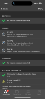

I got “Exhaust System Service Required See Dealer” when idling today. Per manual, the engine must be running (due to factory air on the 2500) when unhooking or hooking a trailer.
See photos attached, I also got a few codes (p242B, P2472, and P0116)… not sure if they were new or just added. There’s no CEL and the See Dealer message was gone after a restart. I had the DPF replaced due to frequent regens ~ six months ago.
I was at 0% on DPF when this happened and it hasn’t budged.
Thoughts?

May have been a fluke, I wouldn't loose sleep unless they go active on the next few drive cycles, I would make sure all of the fuses/relays are fully seated in the fuse box. That has caused issues for people in the past
