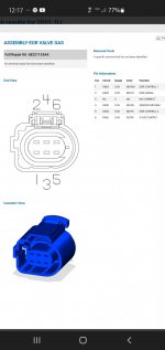

Will pop it off this weekend and take some pictures for comparison. Thank you for the info. Wonder if you can pop the pins out and insert them into the new connector.
You can remove the pins with the proper tool. Should be able to find one on Amazon.
There is a small red retaining clip that you have to slide out. From there they pull out pretty easy. Some were stubborn but a small flat head or pick is all you need to pop them out.
