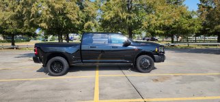

I went with 17x6.5 Ion Alloys and Toyo AT3’s in 255/80/17
Well, some good news and some bad news.
Good news is, the wheels look great and the stance is about perfect for what I'm after. Its practically flush with the OEM fender flares (picture bellow, still on a jack).
Bad news is, there is no gap between the inner and outer. Checking with the company I purchase the package from to validate as it should of been compatible for an even wider tire. Potentially incorrect offset inner.

Wow, that's not good! My 17" Ions are spaced properly, and they are just tucked into the fender.
Going to re mount and measure tonight, I think the 156 offset is correct for the inner, these are 110
That stinks they are touching because that setup looks so darn good! Love how it sits right at the edge of the fender or ever so slightly beyond it! Hope you figure out why they are touching.

I think that is what he was trying to avoid though. Your wheels have a standard offset to them, and that offset makes your wheels stick out a long ways past the fender. Whereas his are flush with the fender if you take a look which is what he is after.
So I had the option of an inner spacer, but have opted to switch out the outer for one with ~20mm more offset. Downside is they are on backorder, but its the outcome I prefer. So on hold for a whole unfortunatley.
Which wheel did you decide on? Or is it the same design with different offset?
Its the Vision 401 Rival, the ones I was sent were 401H2880BMFR (-145mm offset), after a lot of back and forth, were going for 401H2880BMFRL outers, with a -166mm offset. They will poke out a bit, which wasnt what I intended, but the higher offset innsers (156mm) would rub against the inner suspension components. Its probably the best outcome for the moment.
