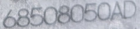

Here's a link to my teardown of this module:
And a couple more pictures:
