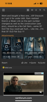

Here’s screenshot that shows the updated version on the left in both of the pictures.
