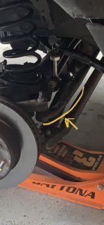

Edit: here’s an old pic of my truck i found on my phone with an arrow to the bend in the drag link

Well if it is like mine it would roll forward and just stay there. Never seems to roll back. In fact in that picture you posted earlier it appears it has rolled forward if my eyes aren’t deceiving me.
