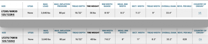

If you have 18 inch tires and wheels what is the total height of tire and wheel? I'd like to compare to what I have now and see if it is an option worth looking into.
Just to be clear; you want to lower your truck (front & rear) by going to a smaller wheel and tire package so your trailer will sit level? If you dropped from your stock ~ 33" tires to 31", your truck would be 1" lower. Just my $0.05 worth, I would NEVER go to a smaller tire on these HUGE trucks. It would be much easier and better to raise the trailer by that same inch... anyhow, keep us posted on what you actually wind up doing! :)
By the way, my stock 18's are just over 33" tall, your stockers are less than a 1/4" taller overall, the difference in height of vehicle would be about 1/8"....

33.2 inches tall for lt275/70-18 vs 33.46 for lt285/60-20. You don’t gain much. Are you sure it has 15” rims, most 8 lug wheels start at 16 inches.
